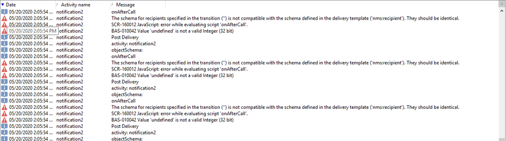

part 2: i have downloaded the recipient file from S3 bucket and when i am loading the data and sending the results to continously delivery. it is throwing the below error:
Part 1: Extracting the results and sending email and storing the result file in S3 bucket: which went sucessfully
part 2:
I am downing the file with columns used as additional data in part 1 and uploading the data in part 2. i am using update data activity in order to linkup the targetting columns with recipient table and then sending an email. it should send only 4 emails but it is continously sending me emails like 20,21,22 and so on.
When i don't use the update data activity. i am getting an error like below :
if i dont use update data activity : My data loading result will be like this :
and i will feed this to continous delivery i am getting this erro:

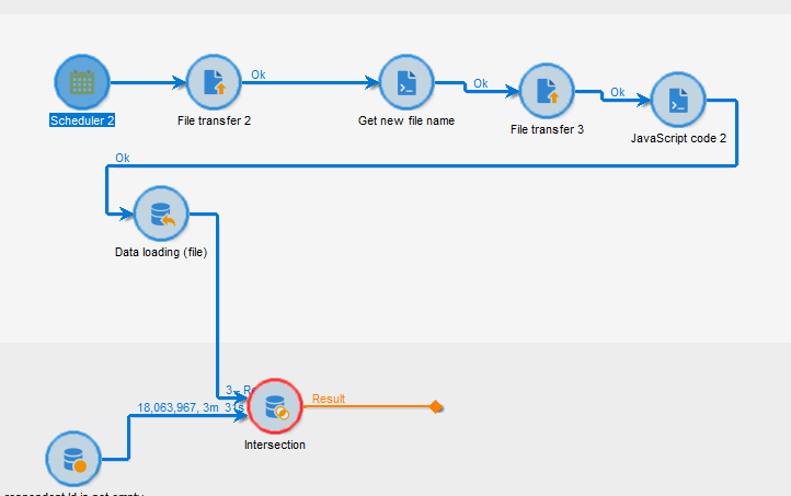

i have followed your second suggestion. kept a intersection query with data loading query:
So i am getting the below error :
Am i doing mistake anywhere. i guess this intersection takes some time as the intersection query should run all the records first and then intersect with the temp table.
Hello @Ramaswami,
I have skimmed over the question and it seems like you do not have the targeting dimension (recipient table linked to your working table) you cannot send an email from a file this way.
The error is also self explanatory that your targeting data are not type of nms:recipient, and which are awaited by the delivery (set by target mapping)

Hi @Ramaswami ,
based on your preferences you can:
  • use node Change dimension node in order to switch to preferred targeting dimension (from temp:fileImport to nms:recipient)
  • use Intersection node and intersect between downloaded file and nms:recipient table before delivery
  • use External file () target mapping which allows you to send email to the customers which do not exist in nms:recipient table (in your case they exist but they are not reconciled)
Take care about data types to avoid these errors Not valid integer. This will break your workflows often.
Milan
hi @milan, thanks for the reply. I have tried your second suggestion and can you see my observations in the my asked question (bottom of the question). Also can you eloborate option 1: use node Change dimension node in order to switch to preferred targeting dimension (from temp:fileImport to nms:recipient) i guess option 1 will be simpler.
you cannot do intersection on table without targeting dimension aka recipient you need to reconcile first with recipient table. change dimension wont help either
