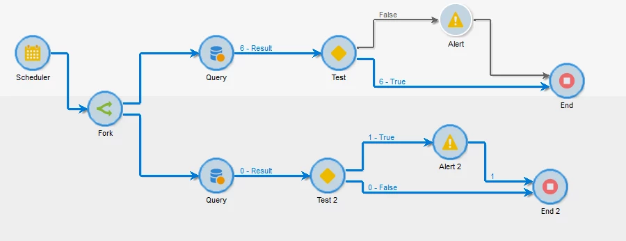

Iam having an issue with a scheduled workflow.
The problem is the workflow got executed 10 mints before the assigned time.
The workflow executes every 30 mints, but today the wf got executed 10 mints before.
The workflow,

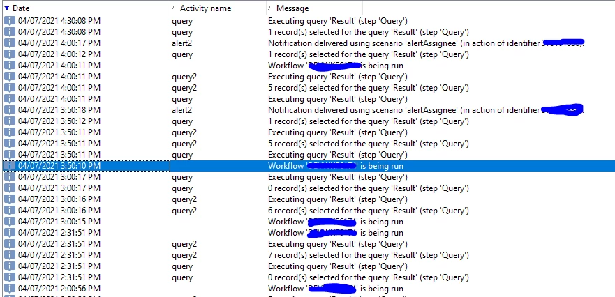

The logs are mentioned below for understanding.
Could someone kindly tell me what can be the problem?

April 8, 2021
Hi @greeshma_sampath1 - There are a couple of strange time entries in there. The first one is when the workflow ran at 02:31:51 PM - that's almost a 2 minute schedule delay. It could indicate your system is under large performance load.The 20 minute delay at 03:50:12 PM is pretty extreme though.
The late starts could also be related to other factors like @craig_thonis mentioned or if a workflow killed the Campaign Jobs (operationMgt) workflow and required a restart.
