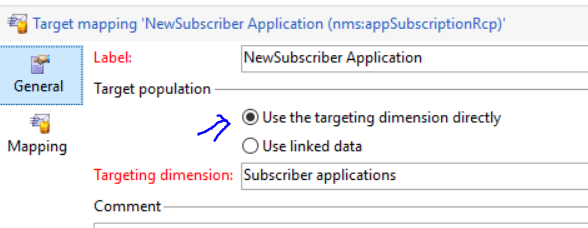

Hi Salvatore,
Yes this is possible by changing the target mapping.
You should target the nmsAppSubscriptionRcp table directly instead of creating a Join with the recipient table.
So the new mapping would look like :
As opposed to the OOB Mapping of :
For the second point, I think this is possible as I see implementations with extended app subscription fields already present with data being fed into that table.

Hello Adhiyan ,
First of all thank you for the response.
Regarding the target mapping, could you explain me how to configure this section?
In particolar, if this is exactly the same for OOTB target mapping or you need to use custom tables for Delivery log and Tracking log and which additional filed to put
Thank you!
Salvatore
