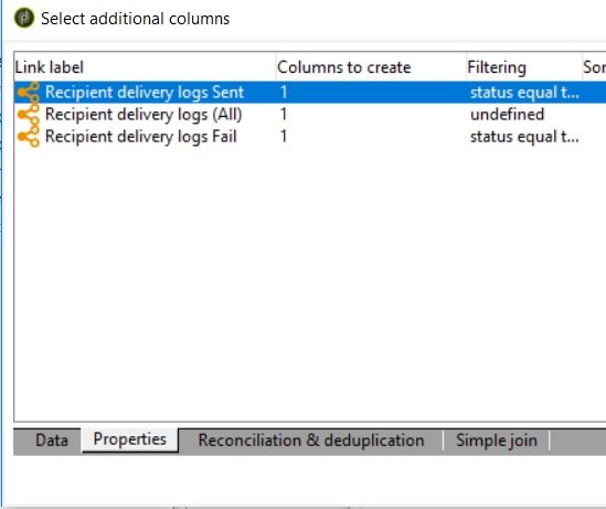

The Enrichment activity creates 3 column, one for each stat with an Aggregate Count(@id):
This way, we are able to configure it with the standard query editor, instead of a db trigger.

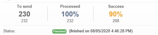

It ends up with well formated delivery stats:
Thank you
