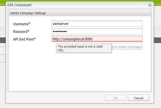

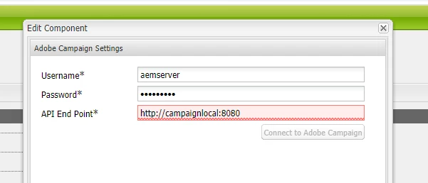

I have installed Adobe Campaign Classic 9032 and AEM 6.5.0 both locally on my computer. I was able to connect to AEM from Adobe campaign but cannot connect to Adobe campaign from AEM. This is because the connexion url (http://<dns>:8080) of my local environment is not recognized and the validation button is greyed. I tried using http://localhost:8080 but the credentials are not recognized in that case (screenshots below).
Who has tried that configuration before?

Yes I have both the author and the publish on my computer and I am following the documentation. And I am able to access AEM from ACC. So I know that ACC and AEM can connect.
My issue is I want to reach ACC from AEM and it is not working because the URL is not recognized as a proper one (see screenshot). campaignlocal is the dns of my ACC instance.
