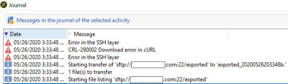

Error while fetching file from sFTP location
I am using File transfer activity to fetch file from 3rd party SFTP location
I have created the external account and configured File transfer activity as shown in below screenshot
However, below is the error I am getting
Any insight on how to resolve the issue will be appreciated

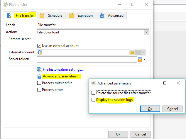

Hello @varshtus ,
Please enable to session logs in the advanced parameters
Then you check the audit logs to troubleshoot at which point the sftp connection is thr
