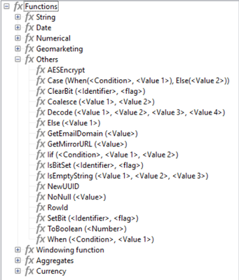

I think you can't, in that "expr=" you can use database functions that you can find in the advanced expression editor of the query activities:
As an example, you can encrypt the @ID with sha512 using expr="Sha512Digest(@id)"
