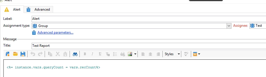

If you are looking only for the volume of your complement result set , then simply use alert activity after your complement to send the total count as below:
You can edit the source code to add your comments .
