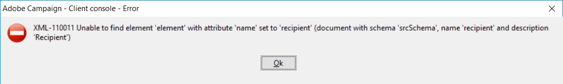

We just migrated from v6.1 to v7 and now I'm getting an error when trying to update/preview any custom schemas, which says campaign cannot find the factory recipient schema definition.
Has anyone come across this situation? We have literally not changed anything else but attempting to preview gives this:

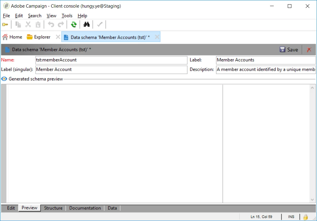

So the schema preview looks like this

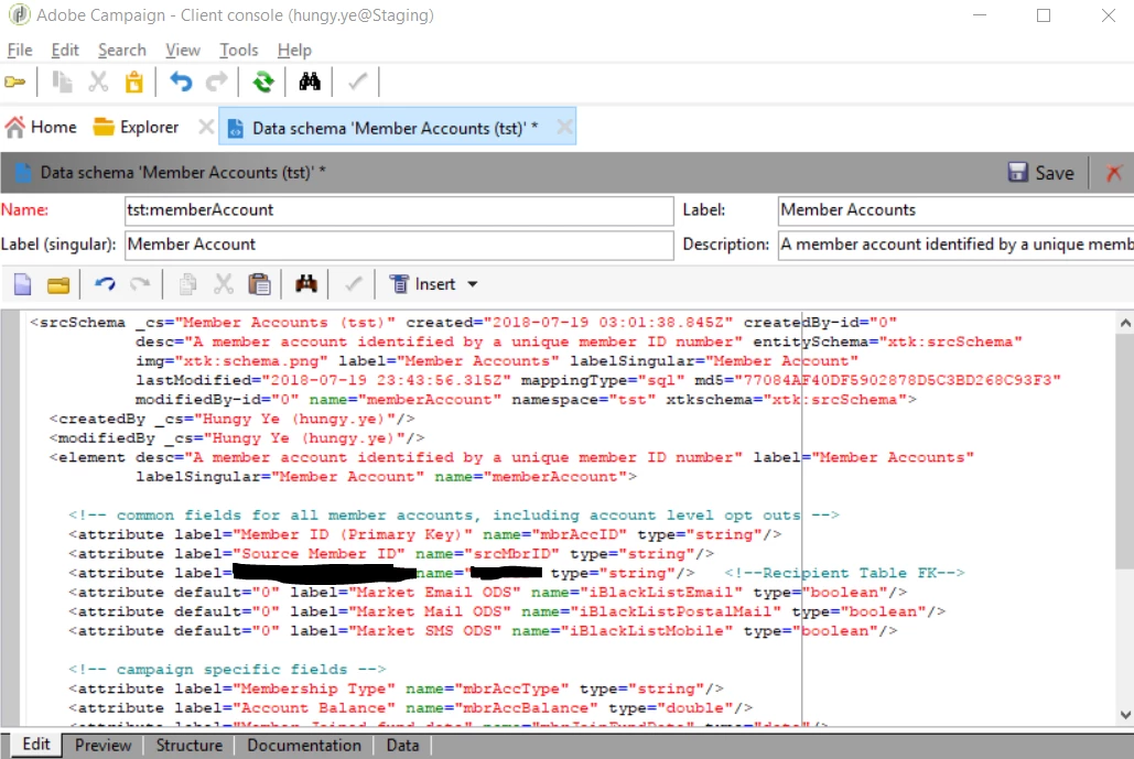

This worked fine before:
The same happens with an extension to the recipient table - I tried deleting it and recreating the same one, but still get the same 'schema not found'

Can you show us the recipient schema? Seems the schema has been deleted or corrupted.

Hi hansangy13779089,
We saw that you have reached out to support team for assistance on this.
To help the broader audience, the issue has been resolved now.
Problem was that someone (not clear who) had deleted the recipient schema on your instance.
We had to contact our hosting team to rung postupgrade -force and get the schema restored.
The issue should be resolved now for you. Please check.
Vipul
July 20, 2018
Hi Vipul,
Yes it seems that the recipient table was corrupted/deleted somehow during the upgrade, restoring it did the trick.
