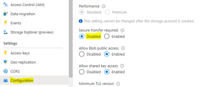

Unfortunately AC uses http as default. I'm not sure if this can be changed. Please ask Blob owner/admin to set Secure transfer required to Disabled:
Most probably new Access keys would need to be generated too:
This small change should resolve your issue.
Regards, Marcin
