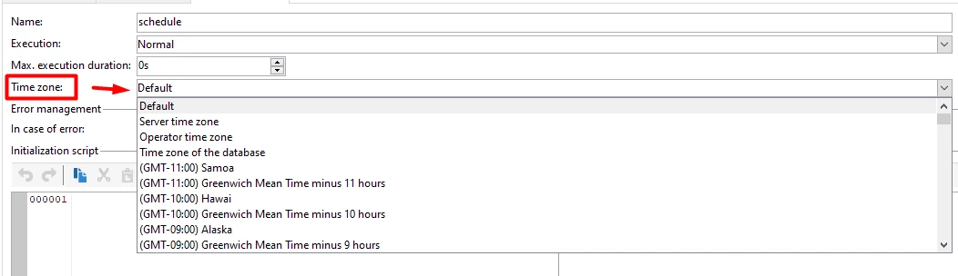

To target recipients in other timezone, you may take help of scheduler and change timezone as needed for that workflow's execution / deployment as shown below :
