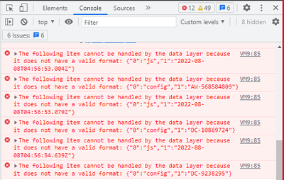

Getting this console error : "The following item cannot be handled by the data layer because it does not have a valid format"
Hi Team,
I saw this error on console not sure why we are getting this can anyone help me to resolve this.

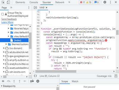

When you click on that VM9:85, your browser console should jump to the relevant line in your web page's code that is throwing the error. Do those lines look familiar to you?
Hi @yuhuisg
When i click on VM9:85 it will showing this and its not showing the exact error type.
Expand the console error message, then click each error line until you find one that "makes sense".
