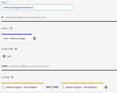

I have webpages as Single page application (SPA) without refresh. I am getting adobe hit for every URL change with the help of History Change event type. Now I am trying to capture some of the data layer objects on every URL change. For this I created seprate data elements and mapped them to evars & enabled a DOM ready event type rule in launch however, I am unable to get anything in the debugger (looks like DOM reday is not right event type). Any suggestions on this?

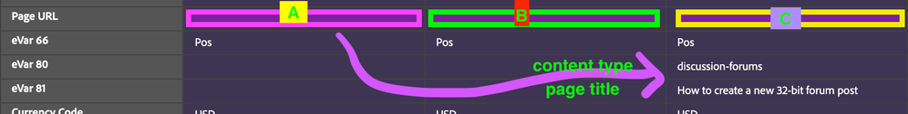

I also tried changing it to history change but I am facing timing issue. The values of data elements are populating later on, which means data elements of page A are populating when page B or C are clicked. Screen Shot 2021-08-02 at 10.04.19 PM.png

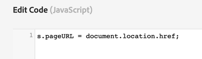

@PratheepArunRaj I have implemented Direct call rule but the hits are happening twice ie. one via history change rule which is pushing page URL update from browser via custom code shown below:
And one hit is happening via Direct call rule.

@PratheepArunRaj on SPA website I have actually made adobe hit to happen via history change rule where I custom code to update the page url like below

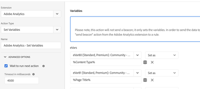

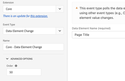

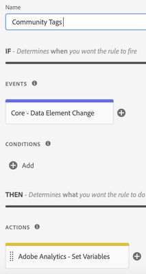

And, as suggested by you I tried using Data Element change configuration as below. I have my Data Element "page title" configured which I am pulling here in the rule event type & getting the evars to triggered.
I have changed the time here from 2000ms to 4500 ms so that event get time to pop the evars value. Is this is fine?
However, the evars values are not coming up instantly for its corresponding page. Its coming up for next page hit. like below

@PratheepArunRaj i tried setting the storage of the Data Element to None then it worked for me correctly. It was may be due to because of the nature of the website. Thank you so much for your suggestion on Direct Call. This actually worked better than history change. We are now able to trigger the adobe hit also through "Direct Call". thanks
