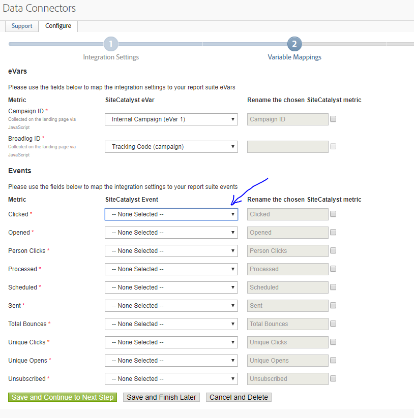

Hi Team ,
I am working on Integration of Adobe Campaign and Analytics, so that I can pass data captured through Campaign, to Analytics as well. For the same, I am following the below link.
https://docs.campaign.adobe.com/doc/AC/en/PTF_Connectors_Adobe_Analytics_-_Data_connector_integration.html
Though, I am stuck at Step 1.7. It mentions “ You should also specify the indicators for events to be collected.”, but I am not able to see any events in the Dropdown in my case. PFB the screenshot.
I also saw that under Conversion > Success Events few events are present and enabled, but not showing up in the dropdown here. Please let me know, what should be done.

Best answer by EricMatisoff
Hi there,
You'll have to first create the events in the admin console, then they will appear in the dropdown.
Be sure to set the event type as Numeric, otherwise they won't show!
EricMatisoff

Hi there,

Thanks ericmatisoff​,
I had already setup the events, but the type was marked as 'Counter', though after changing to Numeric, it is showing up now.
