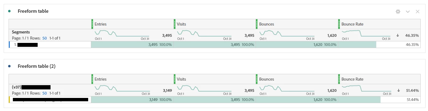

My org has had a few instances of URL paths and/or page names changing globally, so I rely a lot on hit-level segments to replace dimension tables. Something I've noticed is that entries, and therefore bounce rate, does not act as expected in this scenario. When I use a segment that is hit-based with simple (URL = xx or URL = xx2) to combine the pre- and post-change URLs, it gives entries = visits. Looking at the same URLs in a dimension table, the entries is equal to the number of entries on that URL.
I understand the mechanics behind why this is happening, technically each occurrence of URL = xx did have an entry, but that's not the entry I'm looking for if I'm using a hit-based segment. This behavior feels off to me and I'm wondering if (aside from creating my own bounce rate metric that doesn't rely on entries) there's a solution or workaround.

The segment you created is on Hit level but the Entries metric works on Visit level. So let's say the segment you created with definition evar1=Citizen(Hit level). if you apply Entries metric next to this segment it will show the all the values of that evar for that particular visit.
Segment:
Breakdown segment with the dimension used in the segment:
Here you can see all the values of the visit when evar1 was set as Citizen as an Entry.

Thank you @vidurb80577666, as mentioned I do understand what is happening. I am saying this does not seem like expected (or desired) behavior for a hit-based segment. A hit-based segment should report the same analytics metrics as that dimension itself in a table.
I am also asking if there is a solution to report entries/bounce rate for hit segments, given this behavior is not what I need.

Hi @_bel_  (and anyone else struggling with this).
The issue as mentioned is that the total 'entries' to a specific page when using a hit-based segment is replicating the 'visits' figure, which then gives an incorrect bounce rate.
I have found a solution to calculate bounce rate for a page when using a hit-based segment using the below calculated metric. This is calculating bounce rate from a single page visit view but you could adjust the first part of the calculation to show only visits with 1 recorded hit.
